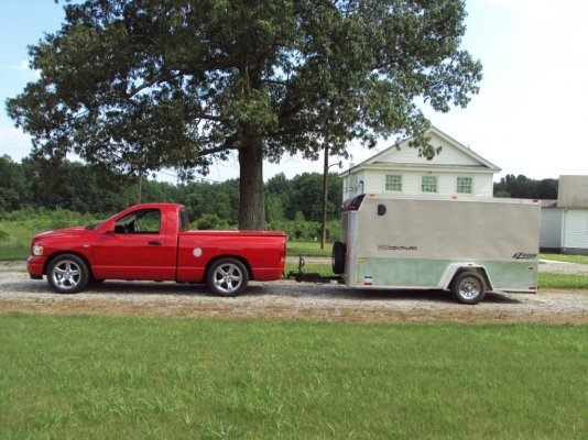

A flip kit really makes it sit/ride nice and a couple spot welds is all that's necessary. These can be easily cut with a grinder if the housing needs to be changed. Air shocks are often used for occasional towing or heavy hauling. I used Timbren rubber springs for a completely passive system.
