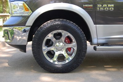

If I might suggest:
Omg lol i literally fall asleep every night thinking if i should get the nitto trail 295/60 or the 65s
I just cant decide
Sent from my DROID BIONIC using Tapatalk
Skirider
Get the Toyo Open Country AT II in the 295/65/20.
No rubbing with a 2.1" level & a great ride
Dante
