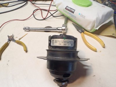

I have attached a photo of the tag on the motor. I see a notation CCW - I presume that means counter clockwise. Does that mean the rotation is CCW viewed from the front of the truck, or sitting in the driver's seat?
