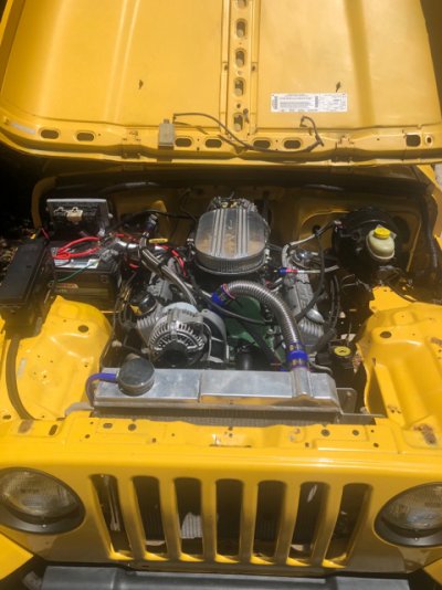

If you want more power on the cheap, 30 over standard pistons will only get you to 365ci or so. But, if you get high compression pistons, that will help even better. The cubic inches wont go up, but hp and torque will. Downside is you’ll need to run premium gas.
Another quick and easy upgrade while you’re at it, would be a hotter cam, as long as you don’t go too crazy.
A stroker like a 408 requires many parts and even a budget build gets in the 1000s quickly done correctly.
