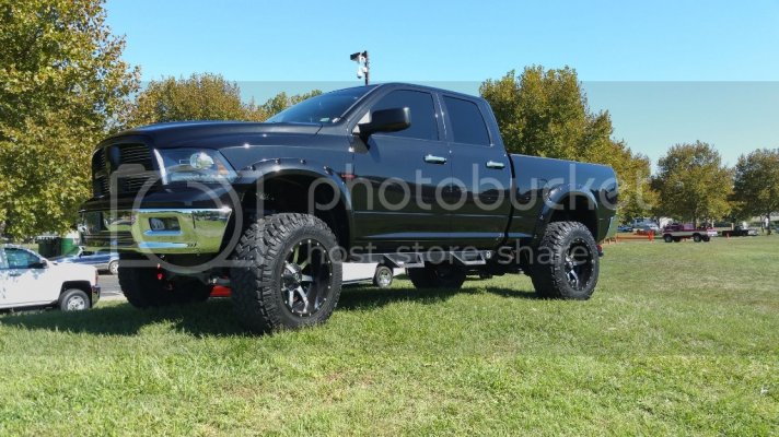

Has anyone adjusted your Fox coilovers while they are on the truck? I got my new BDS spanner wrench today. I want to adjust mine another 0.5". I have done a lot of research on this and I can't find anything on these coilovers on adjusting them. I have a 1.5" rake. I am just trying to get it to a 1" rake. Any help would be appreciated.
