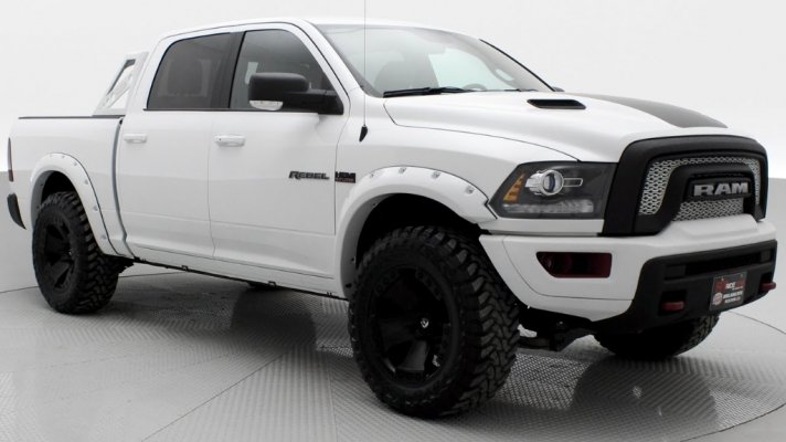

Can anyone guess the lift on this truck? I love it and want to replicate the stance.

Im guessing its bilsteins up front maxed out. The reasoning is that they are a 2.8 inch which on some trucks park the front a tad higher than the rear. Unless my eyes deceive me.
I think someone makes a 3 inch spacer style level, id hate to see the balljoint angles but that could also be the case.

If its a Rebel its not bilsteins, all they come with is the air suspension, that may be just set at the offroad height for pics, or has the arms modified to trick it.

I want a level, but want to do it the right way, or at least what I think is the right way, with bils 6112 front/5160 rear and zone uca's.

Would that height be similar to a bilstein level if it is air suspension set at offroad height for the pics?
