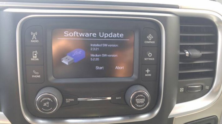

After figuring out that you only needed a sw update to your 5.0 (v2.3.20) for the grid lines to work, I am finally updating my radio as well even though the grid lines worked with v 2.3.21 ...
PS. I should have done this tonight after work, not right before when it's 110 degrees in the truck with the doors shut ... 15 mins and still updating. It's hot in here. [emoji27]
