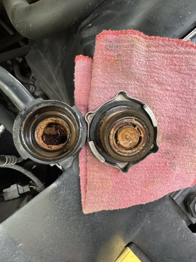

So I didn’t check the coolant in the radiator because they literally just dropped it off and all I did was run it down the street to check the engine light. There was still fluid in the expansion tank though. While I was driving it and at idle, the temperature never got high. I did notice that the heater only works on the passenger, not the drivers side. I assumed that was a blend door issue, but I’m guessing now it could be related.
It could be worse, just a heater out on a Cummins can means over 20k fix and that doesn't even include anything internal. So I am a little curious why they did the egr, on the Cummins heater core issues the egr "cooler" is the culprit and the lack of heat is the canary in the cold mine. Now, with a hemi it is way less of an issue. You can try a heater core only flush, if possible hot water, but that can get casting sand out best you can. Again, I haven't heard anything fatal or more then annoying at this point, until you prove otherwise it is very possible this will all work out rosey. Even if there is a leaking head gasket, it is on coolant side and it very fixable with a product if you don't have any warranty. Do you have any warranty for used vehicles? Most have 30 days?

Took the radiator cap off and full of gunk.
Could just be casting sand, I'd drip a little out of petcock, just check fluid condition. If you don't know how to use the petcock, just loosen the bottom rad hose and fill a clear glass with coolant, post a pic.
A lot of guys don't use the petcock, break it and you need a radiator.
Its not a blend door issue its a clogged heater core 99% of the time when that happens coolant could of also been low.

The coolant on the air filter box means you've got a leak down a bit lower and the fan/air flow is throwing it up on the air filter box. Maybe where the plastic meets the metal, it splits there sometimes, sometimes where a transmission coolant line hooks in and the **** leaks, etc. Then low coolant is probably what is collapsing the hoses as it cools off.
I'd be curious as to what sort of coolant is in there and if somebody has been running it with a leak and topping it off with the wrong kind causing all that gunk. I'd also be curious if it's been overheated multiple times.
I broke my petcock over a year ago. It just turns without getting tight or backing out. Hasn’t leaked a drop. I was ready to order a new one but so far so good.
