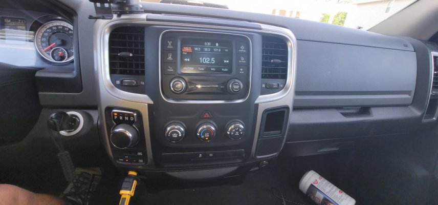

I have a 2019 classic with the 5in radio trying to upgrade to 8.4 I bought a used one from someone who has a new style will it work with a new bezel thanks in advance

I have a 2019 1500 classic which is the first picture shown I bought from a friend what is the next pictures it came out of a 2019 1500 new body style can I make this work and if so what do I need to make it happen
Looks like your trying to put a 5th gen radio in a 4th gen truck. There’sa thread about it in the DIY section and looks pretty difficult to do. @Mpgrimm2 might have more info
You can make it work(I have), but you'll need to fabricate brackets for the screen and find a place in the dash to mount the radio unit. You'll need a display cable and the button interconnect cable. You'll also need a new bezel, and alfa obd to enable the screen.
