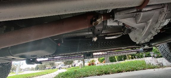

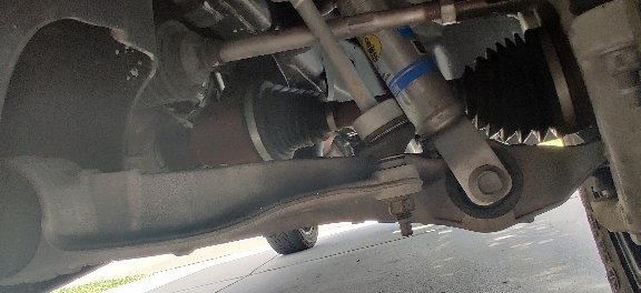

I have a 19 classic also with same issue have not come across with what's causing it, already swap to bilsteins all around, front upper control arms, balance check driveshaft, balance tires 5 diff times and diff ways, 4 alignments, true tires help a bit but vibration still there, install rear shocks spacers and raise truck bit give it a bit rake no fix, I'm running 20x10 -18 offset on toyos RT 33x12.5x20, all the issue started when installed aftermarket wheels and tires I have even replace 2 wheels and no fix, also I have hub centrics.ecec4fcbbb17e463ed172df966c13024.jpg
Sent from my HD1925 using Tapatalk

What are your driveshaft angles? Sounds like it's still a drive angle problem 100%. I'd say it's not a wheel or tire problem at all. You road forced the tires. If there were any pull any problems physically with the wheel or tire the road force would catch that its kinda the whole idea of the road force.
Also wheel alignment has nothing to do with vibration the alignment companies are taking your money smiling. Alignment only causes pull and tire wear.
See pics7c346e7d6ac4e9e8fc91794a45a2878a.jpg0067683c6de221c1376d9903ae790d4b.jpgae1dbc4710c197988e2eb826aedd4338.jpg5d080641ac79941ad1a5459792597745.jpg4078d0b5f632c69fa3f07c46bdff89ce.jpg87f2f6e44a9e17c4f229c396b6a7e4b4.jpg

Ok well all of those look Good. Another question does it only do it at higher speeds? I've seen cases when the torque converter locks up it sets a vibration that may be something to pay attention to.
