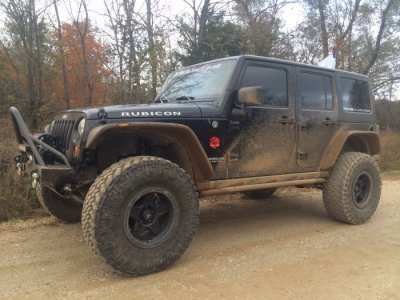

Peak power is not much higher but you don't drive around at peak often. I'm looking forward to seeing a dyno graph to compare torque curves.
I stopped by my dealer and checked out a 2500 Big Horn 6.4L with the Black Appearance package. I would have driven it but I was muddy from wheeling. I'm looking for either a 6.4 or 6.7 to tow my Jeep around the country.
