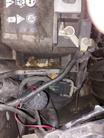

My '21 Warlock has the removable spacer in the battery tray.

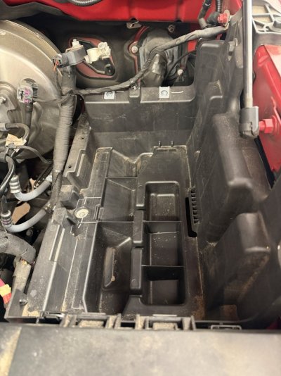

Take a picture of the bottom of your battery tray and post it.
Team Horner
Aug 12, 2019
57
77
Northeast
Sorry I didn’t see this until now.
2022 2500 is the same way. No spacer in the tray. An H7 is the largest battery that will fit in the tray.
My 2018 2500 had the spacer. I had intended on putting an H8 in the 2022, but was disappointed when I pulled the battery to check.
