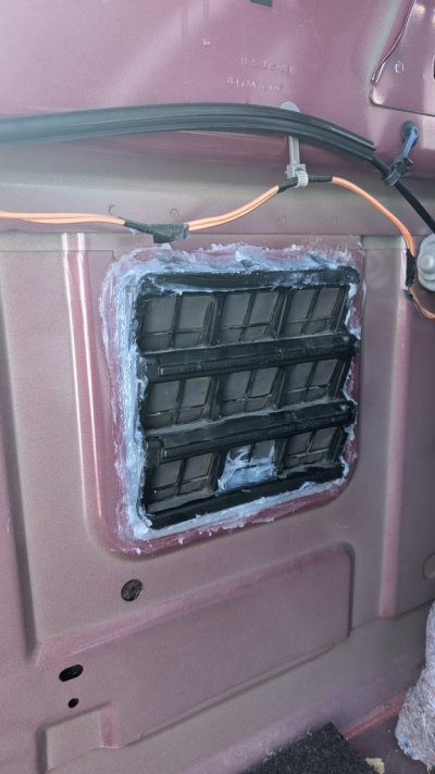

Hey everyone, I’ve seen a lot of posts on this forum and others discussing the exhaust vents leaking following rain with the old style vents. My 2019 2500 came with the “new” vents. All the solutions I’ve seen have involved replacing the “old” vents with the “new”.
I noticed some wetness/moisture under my rear seats and followed all the typical leak path checks. I have an aftermarket third brake light and that gasket seems to be compressed well. I pulled the seats and used the shower setting on a garden hose and got leakage through the vents. This may be a little more direct spray than rain, but considering the wetness following rain and then this test, my best guess is that’s the path the water is taking to get into the cab.
Has anyone experienced leaking through the vent with the new ones? Given the price, I’m tempted to just buy two new ones and see if something strange is going on, but the ones I’ve got appear to be intact, didn’t have any debris, etc.
Garden hose test is the close in pic, you can see the water starting to seep through.
Appreciate any suggestions.
