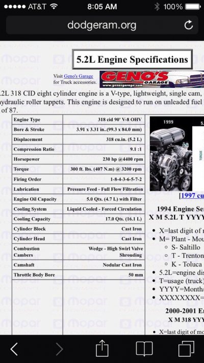

Hello! So I recently purchased a 97' 1500. It's a 5.2 V8, 4x4. The information sorta dies there haha. I hardly know anything about this truck even though I've tried to look stuff up for hours for the past 5 days.
I would like to know more about the engine (like hp&torque), pros & cons, durability, regular maintenance (mine has 106k miles), the 100k tuneup, best tires (I'm looking for 265/75; is that a good size?
Just all the information that you guys can give me about this truck :)

Cool. Im glad u bit the bullet and got it. Im not sure how much different the numbers are for a 5.2 and aa 5.9. I have a 5.9 and stock mine had 235 hp and 330 tq. On the 100k tuneup. Do sparks, wires, cap, rotor, oil/filter, air filter, i would drain the tranny pull the paun and change the filter, do both diffs front and rear. And transfer case. I the last thread i went over the pros and cons of it. You most likley have 3.55 gears. Im not sure where you live but bfg all-terrain ko are good tires. They last a long time look good and as long as ur not in serious muck they are not bad offroad. Ive never had them in snow so i dont know how they do. If u have any questions just let me know.
