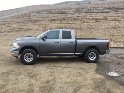

If my truck looked like yours, I would still have my Quicklift shocks on my Ram! Here's a pic of mine with the Fox 2.0s
