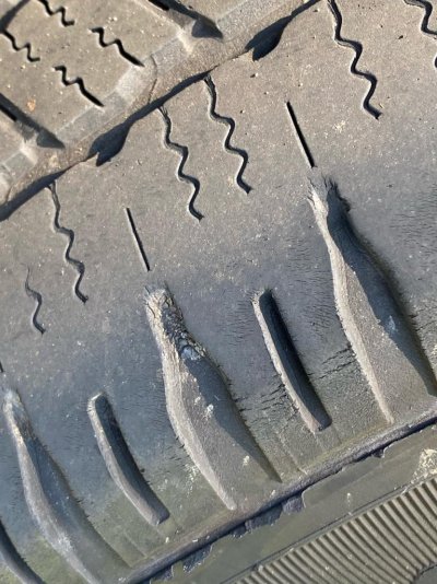

Thanks for the replies guys! I was thinking the sensor was starting to go. As far as the cracking goes, they are small ones starting on the treads, but nothing on the sidewalls as seen in the pic attached. It looks more like the early signs of dry rot to me. Sorry if I didn’t explain that earlier. The tread depth seems ok. I’m gonna go by mechanic tomorrow and see what a sensor replacement would cost me. I probably will do all 4 due to their age, and order Mopar replacements. As for new tires, do you guys have any suggestions? I was looking at Michelin LTX’s or a similar all season truck tire. I live in Los Angeles and we rarely have any rain. 99% of my driving is on city streets and a blast down a freeway here and there. [emoji41]

Your tires actually look damn near bald to me, can't be more than a couple 32nds there! Michelin LTX's are great tires but they are expensive. Of course anything is an upgrade to the factory GY's.

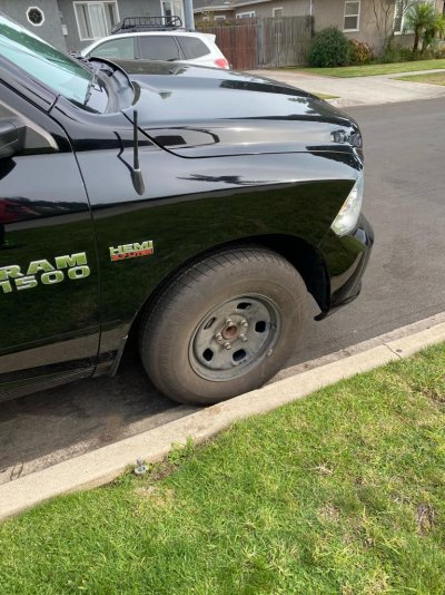

Quick update guys. The Ram is getting some brand spankin’ new Kuhmo Crugen HT51’s in the morning! I picked up a big ass bolt in my front passenger tire at some point while driving this morning. I was hearing a thumping noise and couldn’t figure out what it was. I finally found the culprit. It was holding pressure most of the day but then decided to let go. Luckily I was 2 blocks from home. The tire is totally flat. I swapped out the flat for the spare, and guess what, the spare has a small hole in it! [emoji854] I filled it up but it isn’t holding pressure. I’m having it towed to my mechanic in the am to get the new tires put on. Thanks again for all the help. It’s been a hell of a day!d07ba35afa32411aed49eb642f71626e.jpg
