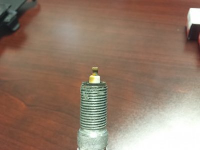

Just wanted to know if these looked ok. About 28K Miles and always running 92 octane. All 16 plugs look pretty much the same. Has a slight orange color almost yellow. Is that ok?

Regap them and put them back in, or you could do what I would, replace them and you will be good to go for another 30K miles.

I did replace them. This is the 4th time I have done the plugs on the truck never seen them that yellowish. Thanks for the input yall.

No octane boosters. Ran Lucas cleaner 2 or 3 times in the 28k miles.

It could possibly be the gas or the additives you put in, either way there's nothing to worry about. They are worn, but normal.

I know this is an old post but that yellowish color is from the fuel treatment you put in. Also if your truck is stock it will run better on 87 octane than 92. 89 octane preferred 87 acceptable. Research "octane rating".
