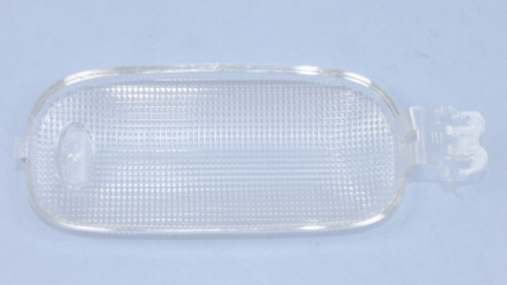

Any tips on how to keep the rear dome light in place? It falls out every time my kids touch it to turn it on.

Are the clips that hold it in the hole still there? The hole doesnt look buggered up.

the lens has a clear plastic tab as a part of it that would be on the side that looks like you're currently missing a tap what happens is that when you open the lens by prying down on it it rocks that normally attached tab up and allows you to pull the light out.
