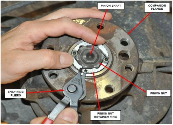

I have an 05 ram 1500 4x4 that has a loud rear end whine while accelerating and cruising. At Around 35 the noise starts to get really loud and peaks at 45-55, as long as you are cruising the noise is there but as soon as you let off the gas it goes silent. Would this be a symptom of a bad pinion bearing?
Oooh ooh! I know this one! Before you spend any money, check the rear differential pinion nut. If it's loose that'll cause your noise, I just tore apart my diff and swapped out gears while installing an LSD and the pinion nut was suspiciously loose and there were no metal shavings in the diff fluid.
aRBee4863
Apr 1, 2022
23
18
Boise, ID
2005
So I thought my issue was caused by bad gears, but in retrospect it was probably that pinion nut getting loose that caused the issue. There's even been a recall (you have the 9.25, right?) and they install a pinion nut keeper. If yours hasn't been by for the recall, they might even do the work for free at the dealer? worth a shotRC-P77-15-49.jpg
