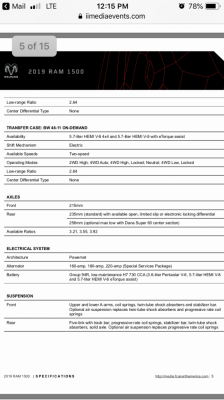

I was pretty bummed when i bought my ram, to learn that there was no factory e-lock option... shame no one could come up with one. I dont supposed those new 2019 ram e-locks fit in our 4th gen diff case?

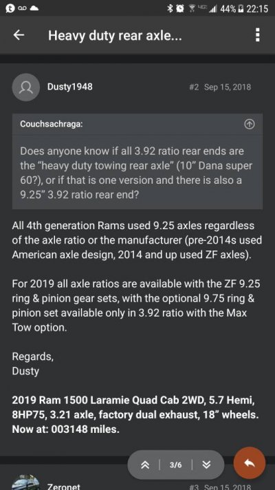

Wonder if the guts are the same and they moved to 6 lug shafts. My Google fu is weak tonight. a2f5829b26eb9ae687adff67ec9460f1.jpg

I was just reading that thread. I'm definitely curious to know if that ZF diff is the same and if those axles run the same 31 spline on the diff side.
If that e-locker fits I'm willing to bet you'll have to sell your soul to the man at the dealership parts counter to afford it. Who makes the e-lockers for the 2019s? If its eaton you may be able to source them without the mopar stamp and knock a couple hundred off the price tag.
At some point I plan on finding out for the sake of curiosity even if I have to be the Guinea pig. Besides the wires going into the housing, I'm not sure what else is different.

From what I've found in my weak Google searches, it seems it's still a 31 spline, 9.25 ZF just went to 6 lug outers now.
Maybe this might be similar to the Rubicon to non Rubicon parts swaps where you have to figure electronics out on your own but the parts fit and function.
