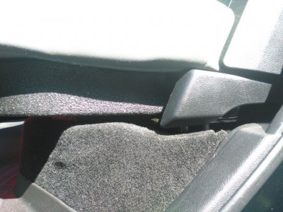

Lifted mine about a inch on my 2013 and seat still won't fold down. Front bolts actually screwed in(stock) but back ones won't quite hold. Nobody ever rides in back except my dogs on camping trips, but I still want longer screws to go as deep as stock, around a inch. My sub just touches the cloth under seat, so want it a little higher, then put grills over both subs.

you need to lift at least an 1 1/2", and yea you're gonna need longer bolts...so keep adding more cheese or washers whatever you prefer
