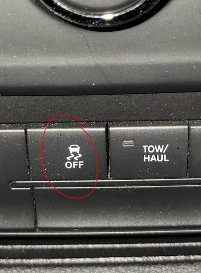

Try disabling your traction control before you pull out. <for some reason that sounds kind of sexy>
Actually I never used that one. I changed gears but no change. Is that the left button in the picture? What does it do, prevent spinning??
That's the correct button. Turning it off allows you to spin. In certain low traction situations the traction control takes away your momentum when you'd actually be able to make it if you let the wheels spin a bit and keep moving. Helps in snow and mud, but not sure on sand.
