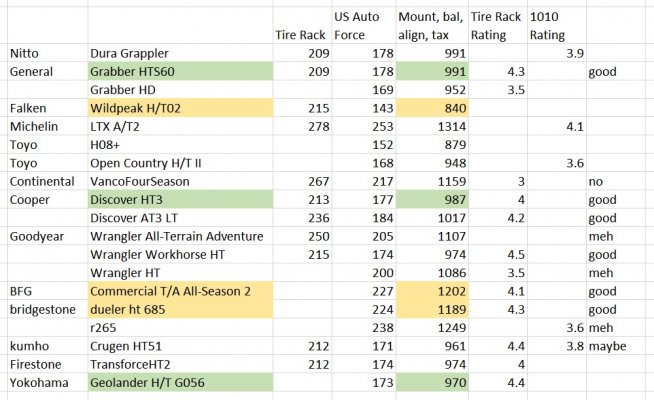

From all my reading, I narrowed it down to General Grabber HTS60, Cooper Discover HT3, and Yokohama Geolander H/T G056. Of course I ignored that and settled on Falken Wildpeak H/T02 despite it not having a single review online. I've had great luck with Falken in the past and am hoping it stacks up to the HT3. Their previous generation HT tire was bad. The HTS60 is byfar the internet's favorite. It's real tough to ascertain a tire's hauling capability cause I imagine the rating sites are severely biased toward daily driver type folks.
The Wrangler Workhorse HT should probably be on the list, but Goodyear has an unproportional amount of hate online. It seems that they have a QC problem. That's probably just a brand loyalist (disloyalist?) type thing tho. My truck came with Wranglers. They started getting lumpy at 13 years old, no rotations (evidenced by tread wear), but unknown mileage. I'd probably say those were good tires.
Edit: this list is specifically avoiding any snow or cold type tires.

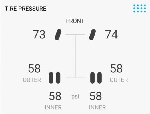

Reading your post just reminded me. I can't remember exact date but it's been a couple if not 3 years since I got the Falken Wildpeaks. I run 75 front and 60 rear in my duallies. This is the present pressures. I've never had to add air in the 24k+ miles. And can't really detect wear. Pretty Wild, in comparison to my wife's truck that needs air every oil change.

"I run 75 front and 60 rear in my duallies."
Is that normal for dualilies??
The usual is more pressure in the rear, less in the front. e.g. mine is not a dually but 60 front 80 rear.

With the Cummins, my dually put 5400 lbs on the steer axle. I always kept the fronts 75-80. I ran 50 in the rear when empty, and 65 loaded up.
