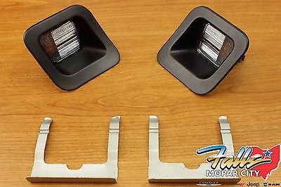

Purchased license plate lights. It's the whole assembly from recon. No directions. And customer service stinks!
Anybody know how to remove and replace with the recon housing led's?

I looked for a video and didn't see one. Can you look at the clips/tabs on the new unit to figure out how the OEM one is held in place? It should just push out somehow.

If you look behind the bumper there is a U shaped piece that just pulls out. Then you can unplug the lights and remove them.... it's super easy!!!
