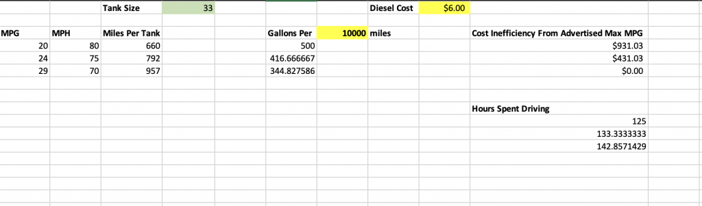

What is your fuel cost difference going to equate to in time to make switching the gears actually beneficial? How long before you turn profit. And these trucks turn into brick walls above 70mph anyways so the aerodynamics and drag will greatly reduce your fuel efficiency above 70mph anyways.
I did some rough calculations on this assuming 70mph is the advertised 29mpg and at $6.00 per gallon diesel.
If I drive as I normally do, ~$930 extra spent on diesel per every 10k miles along, you're gonna laugh at me for pointing it out but, an extra 17 hours per 10k miles lol.
So assuming total cost is ~5k to go to 3.21, it would take me a 50k+ miles to recuperate the cost. I'll probably be ready to trade it in for a different ram at that point before I can even get to 50k+ miles as it will be in some years lol.
