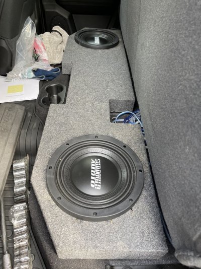

Just wanted to update you guys and thank you for helping with my questions. I ran my remote wire to the #65 fuse and finished installing my system 2 days ago, just haven’t gotten around to posting it with being so busy with work. Extremely happy with this setup but will either need a better battery or a bigger alternator as my headlights dim when hitting hard bass notes

I am glad you got your beats installed. I would recommend two piece to your system. 1. Upgrade you battery to an Optimum Red cap & 2. Maybe a capacitor (if the lights keep dimming after the battery install). I have a cap in my ‘96 Chevy Caprice (MuleDawg) with a red cap and pushing two 15s orions and I have no dim, just power. Good luck

appreciate the advice! i was looking at upgrading either the battery or going with a bigger alternator but i do think im going to go with a new battery before i swap the alternator.
