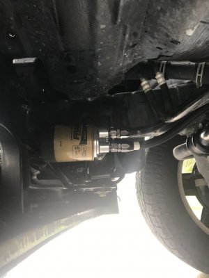

Anyone have pics of where you located the filter with the kit?

I'm taking the kit to a major truck repair facility - they work mostly on semi tractors, delivery trucks, box trucks, etc. They're going to do the install for me. I simply don't like crawling under my vehicles now... maybe 15 or 20 years ago, but not now! They're going to build their own hoses and connections, instead of using the ones that come in the kit. Thanks for the tips, guys. I cannot wait until I have that filter in a location that a human can reach without getting multiple bleeding gouges on the forearm! :)
