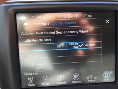

If you have the 8.4 display, it is an option as to what turns on when the remote start is activated.

Is this what is being discussed?

If I'm not mistaken, you can have the heated/cooled seats and the heated steering wheel turn on at every start of the truck.. I have. 2015 Ram Larmaie 1500 and I can do this..
The Auto On for heated and cooled seats/steering wheel only work below and above certain temps.... that is his complaint
