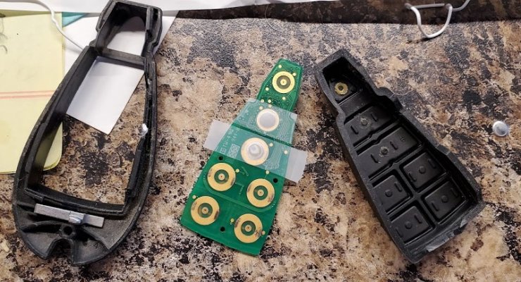

I'm gonna have a take it apart and have a look. How common is this issue?
It's a common issue. When I got my 2009, the seller told me he took the batteries out of the fobs because he would find the windows open randomly. My truck doesn't have remote start but you can open the windows with the remote. I took them apart and found the discs floating around in there and a lot of grime. The circuit boards themselves were fine so I just bought new cases. This way you don't have to program them and everything is fine now.
Attached is a picture of one of my Fobiks. I taped the discs on to test that it was working otherwise before replacing the case.
