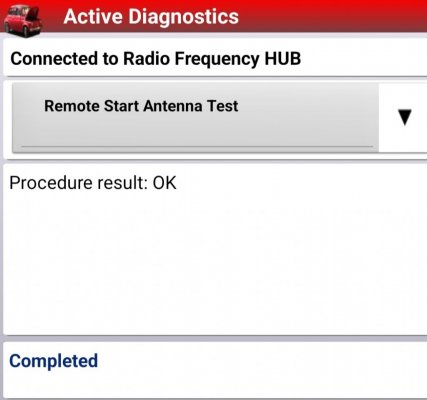

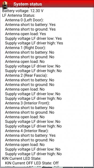

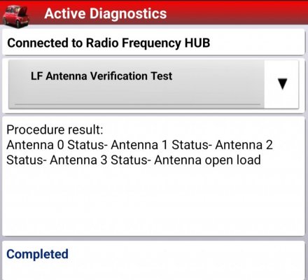

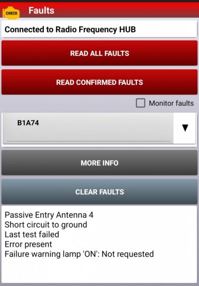

Hey everyone, this site has been super helpful in the past so I'm hoping you guys can help decipher this one. AlfaOBD shows that some LF antennas are failing, which I assume is preventing the remote start from working. It looks like there are issues with the left door and interior rear antenna (but it's only throwing a code for antenna 4, interior rear). I have tip start and from my research on this site it seems that the interior rear antenna against the rear cabin wall and the interior front antenna under the console aren't needed for remote start, just for push button start. Do I just need to replace the left door antenna (or find the short in the cable to that antenna), or, since there's a short in the rear interior antenna, could it cause a problem with the two door antennas, thereby preventing remote start from working? Just wondering if I need to focus on the left door antenna, the interior rear antenna, or both. Appreciate any ideas you guys have.

I believe the RF HUB was introduced in the new electrical architecture that came out in 2013 production. The RF HUB was responsible for TPMS and KEYFOB remote commands. The passive entry and keyless go were on a much lower frequency, I believe around 120 kHz.
Having issues with the low-frequency antennas should not affect KEYFOB remote commands unless the issue is within the module and the report of shorted antennas is a false positive pointing to other issues.

Yea I thought it may be the RF HUB as well. Wonder if there's any way to test that without pulling the back seat. But isn't the remote start system sensitive to any error codes or check engine lights and won't work when it detects one? I know the shorted antennas aren't tripping a CEL on the panel, but do you think the error code could be enough to prevent it from remote starting?
Just FYI, when I do click remote start, the instrument panel does light up, indicating that the truck does seem to receive the signal from the key. Perhaps the start sequence stops once it detects the error code? I'm stumped.

The only information I know that prevents a remote start is what is listed in the owner's manual. To go any deeper we would need access to technical documents and perhaps dealer-level diagnostic tools. AlfaOBD might be of help but I'm not sure.
Another option albeit painful, is to pay the dealer for diagnostics. If it is the RF HUB, a replacement will need to be programmed to your vehicle.
