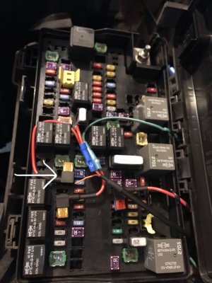

I would tap the radio power and use it to power a relay. That’s what I did for my truck. There is a fuse in the tipm that controls that and you can use a fuse tap so it’s easily reversible without cutting wires.
I'll look into this option. I figured I would need a relay if I found a wire. The cameras don't pull very much power, but I'd rather not risk anything.

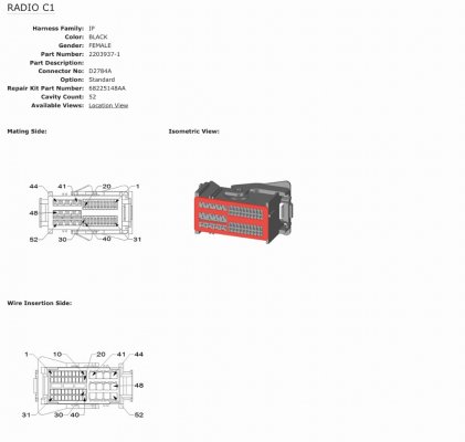

The radio has power when you remote start.
Yes, but the power wire to the radio is ALWAYS hot. The OP made clear he’s not looking for a constant hot wire, and IRSmart didn’t mention if it matters.
I’m looking to wire the same way OP is, I assume. I want my dash cam to come on when I remote start, but go off when I turn the truck off. I know that the rear sliding window, for instance, is not hot until you hit the ignition button, because my radar detector is currently wired to that and won’t come on until I get in the truck. The radio has both a constant hot and an ignition hot 12V, but I don’t know when the truck turns the ignition hot wire on, if it’s when the button is pressed, or if it comes on with remote start. While I’m more than capable of running diodes and multiple power sources, that’s just too much work for a simple dash cam, I would just live with it not coming on with remote start.
Jimmy07
Feb 23, 2017
3,507
3,548
The radio has only one power supply, and that’s fuse battery, which is always hot. It is canbus that makes it come on with ignition. The way I mentioned is the quickest (and only way) to achieve what you want.
Is there a pin out for the 8.4 radio for a 2018 laying around? I don’t disbelieve you, I just subscribe to the “trust but verify” philosophy.
Jimmy07
Feb 23, 2017
3,507
3,548
ZISsFAa.jpg1XyzKxq.jpgAnd here you can see the one power supply coming straight from the battery - SnMmrYS.jpg
