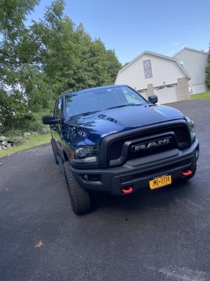

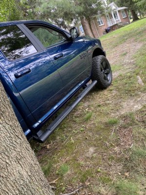

Gave it a good wash. Still some glue residue on it, but not too bad. Will try my orbital buffer to see if that takes it off.
I have 2” wheel spacers on and not sure how I feel about them without the flares. Some angles it looks great and aggressive. Other times it looks kinda silly with the amount of poke with a skinny wheel. Thinking of taking them off.
Some pics:

Second pic is the only one that to me looks a little off with the spacers. But at the end of the day if you don’t like em they are easily removed and if they don’t go back on they are easy to sell and ship on here...

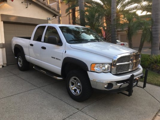

I put some on my 2004 a couple of years ago.
I'm not worried about rust here in Kalifornistan.

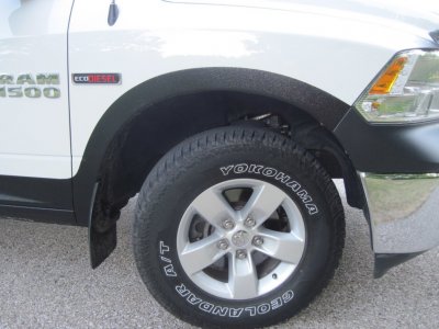

I have had my stock flares on for almost 4 years. Before I installed them I put the 3M protective film on the fenders underneath where the flares would bolt on. I removed the flares about 3 months ago to replace the 3M two sided tape and found there was no sign of rust and the paint under the flares was just fine, no scratches or no sign of the flares rubbing against the paint. If you have wide tires that stick out past the wheel well and you think your flares are going to cause damage, wait until you see all the rock chips and damage road debris will do to the rockers of your truck without the flares. One thing you can do is install the 3M protective film on rockers including behind the rear tire. This may save some of the damage you will surely sustain. While some flares are not wide enough to cover the complete width of some wide tires, they do help prevent most rock chips and other damage. Just IMHO and based on my experiences.
