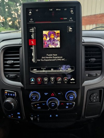

I'm not saying it's not possible, but you'd be better off trying a Ram specific radio for radio upgrades. I too am a an avid modder and currently working on a project to add 12.1" screens from 2019+ 5th gen trucks to 2013+ classics...it's going very well.PXL_20250731_002544115.MP.jpg

I'm not saying it's not possible, but you'd be better off trying a Ram specific radio for radio upgrades. I too am a an avid modder and currently working on a project to add 12.1" screens from 2019+ 5th gen trucks to 2013+ classics...it's going very well.View attachment 572385
Holy smokes! That’s insane! I thought the radio upgrade I was getting was OEM. I’ll put a picture down below.IMG_0765.png
