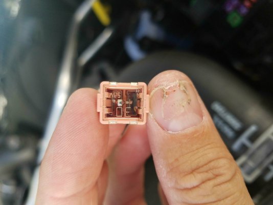

I think I found the culprit. F11 in the fuse box. ITBM/trailer tow brake. Fuse was busted. I still cant believe how dishonest the selling dealer was to try to get me to reprogram the computer. I probably would have paid an all they would have done is change the fuse. SMH.......76b9595be30819f18e43beb01449e759.jpg

Smh.....Put a new fuse in today and what do you know, I got a hot wire. Sure glad I remapped the computer.........yeah right. I almost want to take the truck back with the brake controller installed just to show the techs. It worked and I didn't even have to spend 185 dollars. Freaking dealerships. Live and learn.b13d2b9ea899b310b2c99b9128b6e4dc.jpg

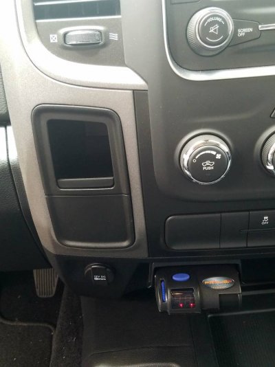

Final. Plug and play. e30a50ef6739db7ee212fca9505d9e46.jpgfdd0ee78aee4195379554fc9282298ef.jpg
