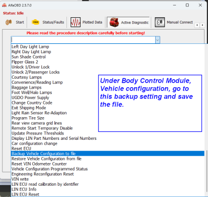

Another thing, how do i save what i have now so if i mess something up i have a point to go back to?
Thanks!
To save configuration file:
