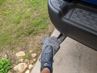

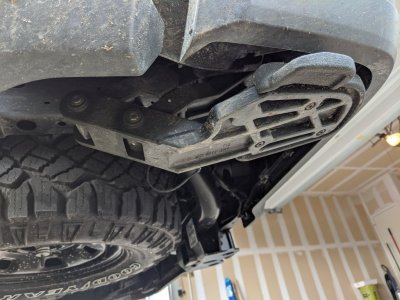

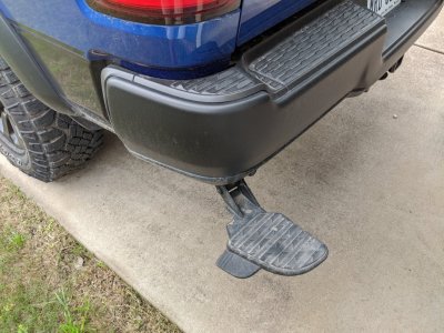

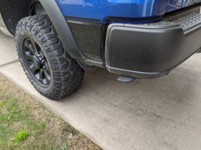

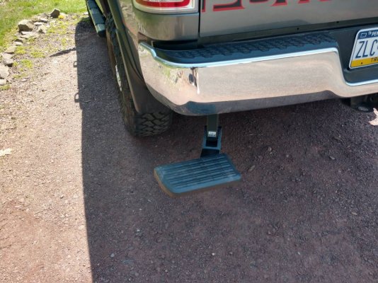

Gave up waiting for my voucher and just grabbed one when I was at the dealer for service today. Dealer understood my frustration and sold it at close to their cost. I like how low profile/hidden the mopar step is. I've seen a few pics of the old version and this bracing on this one is pretty beefed up.
How was the install?
Install was cake. Would've been easier if I had standard sockets and not just metric. You pretty much pull 3 stock bolts (largest being standard equivalent for a 24mm) and install either reusing hardware or with new supplied. I did it by myself in about 15 minutes. It goes a lot quicker with an impact wrench (as most wrenching does).
OA
Short clip showing how it looks approaching the truck: https://imgur.com/xr4gQ7X
