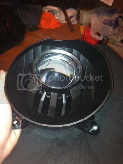

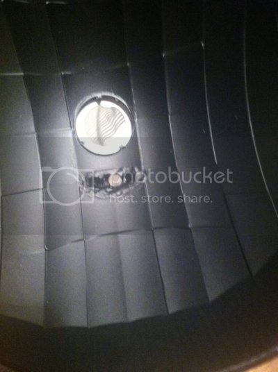

03-05 are really easy to open, I can open then in a few minutes at this point just don't force it
This is the part I'm ground down and drilled a hole through for wiring
You cant see it once the projector is installed
