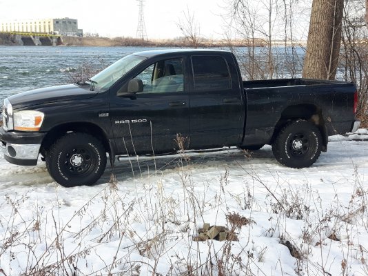

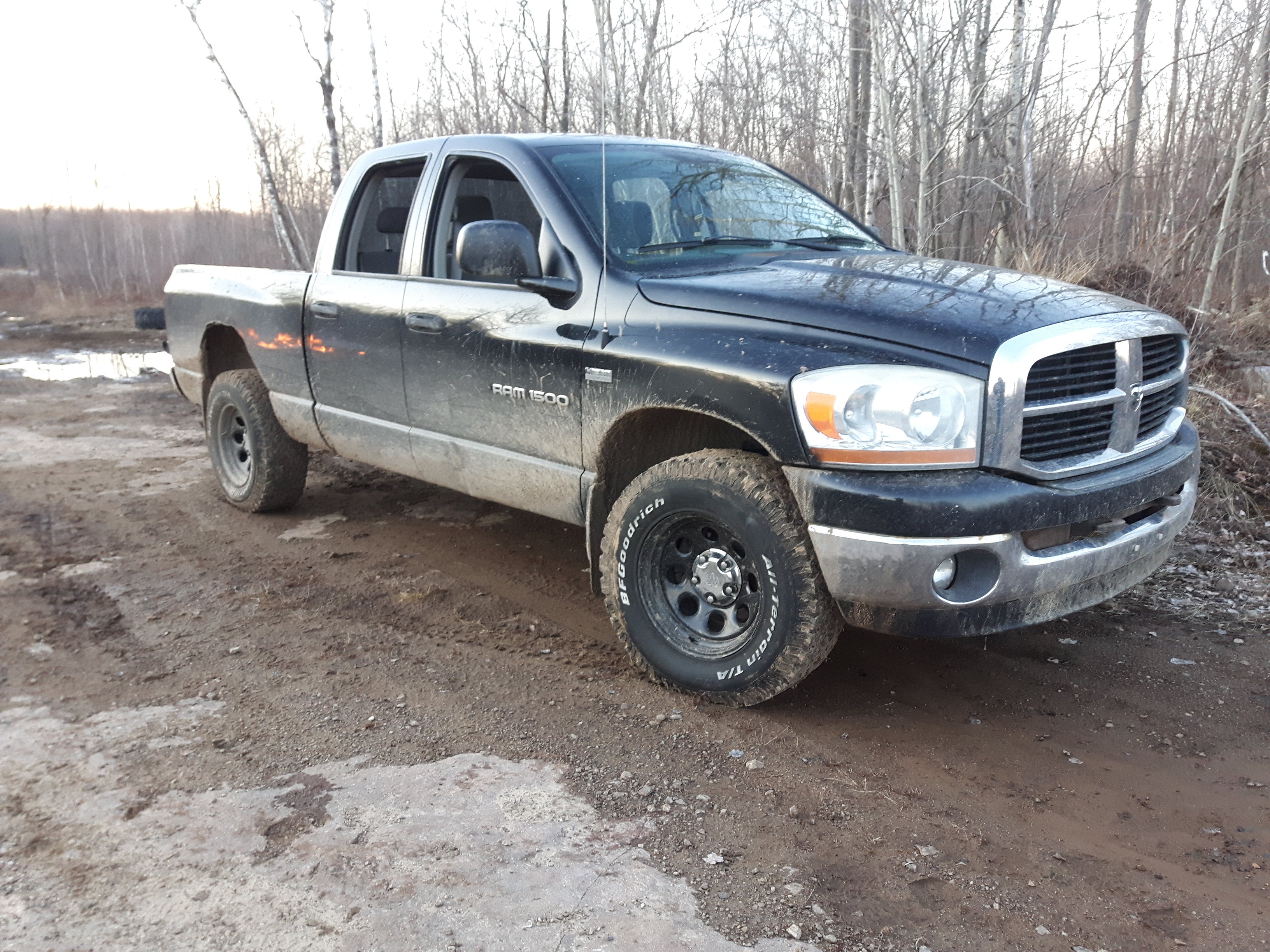

the truck is around 278 000 kms with the superchips 87 octane tune airaid jr intake tube and a flowmaster super 10 copy. still pulls harder than the day i got it, makes me smile every day!
bonus pictures
