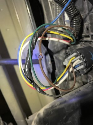

I'm installing a Recon light strip above the bumper and need to tap for reverse light. Does anybody know which wire it is? Thanks in advance!

I assume you want it at the taillights. I'm not sure if its the same there or not so I would test with a multi meter.
However if you go to the BCM its a White with Tan stripped wire. Located in the 48 pin plug labelled F in position 41. The BCM is in the Drivers Kick panel.

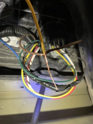

I don’t remember 100% but I know for sure it is either the black or brown wire off the 7 pin. I tapped mine for reverse lights. Get a multimeter and have someone put in reverse and check it. Here is a pic how I tapped the wire with out cutting it. I separated the sheath and used a pick to poke a hole in the wire and wrapped the wire around and black tapped everything nice and solid.
