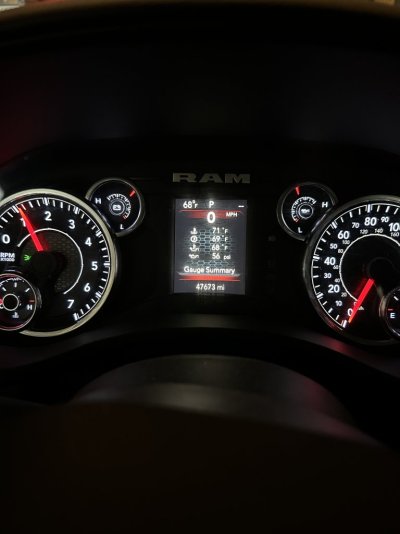

64
Arkansas
Review the attached picture and see if I’m just overthinking the oil pressure being low. This is a new to me truck, and want to be sure it’s running the way it should since my 2006 obviously wasn’t this fancy.
Thank you!

Hot idle, that looks fine.
Mine is 39-40 at hot idle and will hit a little over 50 while driving. That's with the Pacbrake remote oil filter housing, it lost a little max PSI but nothing at idle. Also 5w30.

That looks fine to me. . If you are running down the road at 70 mph then it’s a bit on the low side.
It runs about the same consistently. I haven’t done my first oil change on it yet but it’s only been about 2k since it was changed last. Previous owner said he used full synthetic. So maybe it’s just due for a change. I just didn’t want to run into engine/lifter/cam issues that destroyed my 2006 Ram and forced me to sell it and get this new to me truck

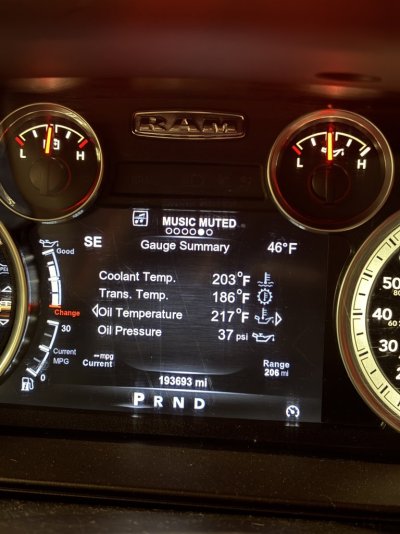

Check out the note at the bottom.This was in the big 700 page printed manuals and the big online manual up till 17,then supposedly they had to remove it,because the trucks apparently wouldn't match the claimed milege numbers.

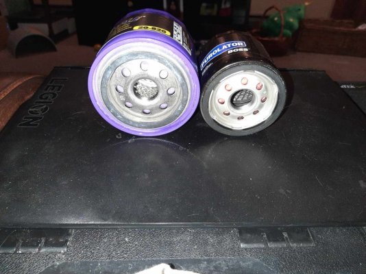

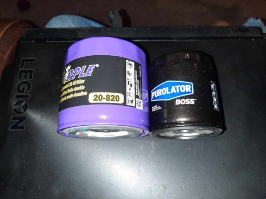

What oversized filters are you referring to?
Yes, as @Ken226 posted, there are several "oversize" filters that are a perfect fit
for the threads and gasket on our 5.7L engines.
Fram makes 2 that have tested very well and are often mentioned here.
I am currently using a Purolator Boss PBL-24651 filter but I have several Royal
Purple 20-820 filters waiting in my garage and I'll be going back to that.
As for the difference, see pics. *Note* this pic is from a couple years ago and the Purolator filter shown is the stock/standard type filter, not the 24652 I posted about. The PBL-24651 is the same size as the rest of the "oversize" filters. Some of the latest reviews on Purolator Boss are a little mixed. The R.P. and better Fram filters seem to be testing consistently. Probably one of the greatest tie-breakers in deciding on a filter is availability. The Fram filters are often found at your local Walmart
