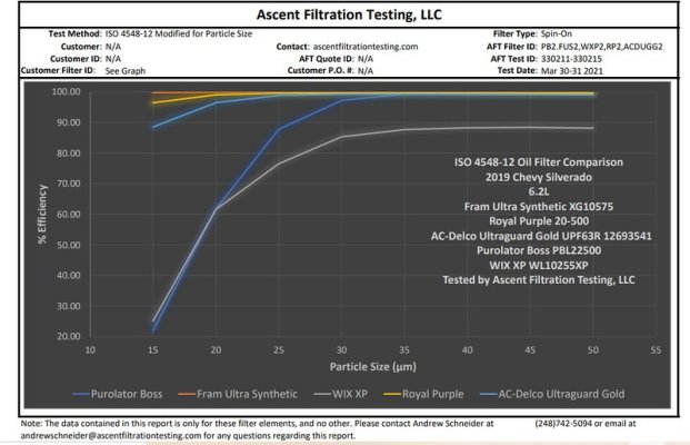

Yes, as @Ken226 posted, there are several "oversize" filters that are a perfect fit
for the threads and gasket on our 5.7L engines.
Fram makes 2 that have tested very well and are often mentioned here.
I am currently using a Purolator Boss PBL-24651 filter but I have several Royal
Purple 20-820 filters waiting in my garage and I'll be going back to that.
As for the difference, see pics. *Note* this pic is from a couple years ago and the Purolator filter shown is the stock/standard type filter, not the 24652 I posted about. The PBL-24651 is the same size as the rest of the "oversize" filters. Some of the latest reviews on Purolator Boss are a little mixed. The R.P. and better Fram filters seem to be testing consistently. Probably one of the greatest tie-breakers in deciding on a filter is availability. The Fram filters are often found at your local Walmart
