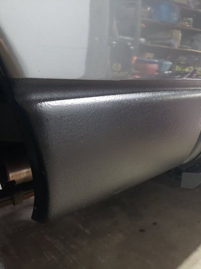

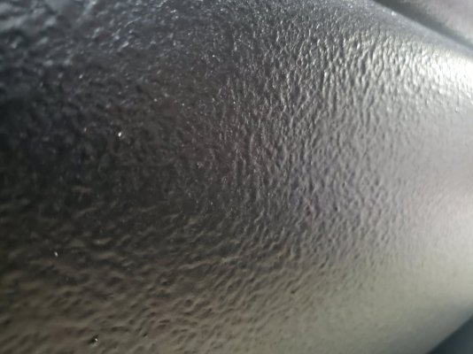

Looking to match this paint that was on the truck when I bought it. Kinda looks like a bed liner but not sure which brand. Any thoughts/suggestions are greatly appreciated!303317064_843401943697285_85033014201073907_n.jpg301981298_2983014915324786_6883650899499179272_n.jpg

Yo, that’s been bed lined, then painted over to colour match the truck. You can get bedliner in different colours, however if you looking to match your truck’s paint code, best to go to a store that sells dealer colour code paints and paint over the liner after it dries. Canadian tire/car quest/Partsource/Maslack stores do in Canada that I have used in the past for colour code paints. Probably more stores around that I don’t know of and I don’t know of any stores in the US that sells them as I don’t live there.
