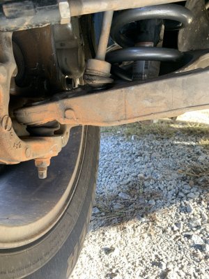

Since he mentioned the Upper ball joints do you see anything wrong with the photos I posted?

Regarding your question being a common issue, i dont think there is one per se at least when it comes to the shop perception regarding the springs being too stiff. RC is not exactly known for heavy duty coil springs, they're cheap so if you're on a budget they fit the bill. You gained perhaps more than 2" ? which will explain why the UCA angles looks bad.
Droop the front tires in the air and take a picture of the UCA BJ angles. They look literally maxed out at ride height but i don't think you have a lot of droop left in the shocks. Are you shocks stock or di you go with the ones they sell for the 2" springs ?

Alright so a different shop looked today and managed to get everything in spec for the alignment. However, they also commented on how stiff the springs were and based on my photos (since I forgot to measure before lifting) it looks like I ended up with 3" in the front.
I'm going to go with Maxtrac's leveling kit and fox shocks instead and return the RC springs. Anyone got advice on where to purchase or how to get in touch with nick from got exhaust?
