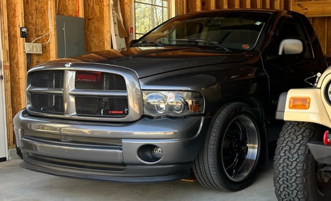

I made it from rubber garage door seal

Yes, both. The rubber lip is attached from the bottom to the plastic valance and just forms to the front of the valance, that's why it fits so well. The trick is getting it attached though. It's actually a 2 piece rubber lip welded together. My last one (done identically) lasted perfectly for 7 years or so until I ripped a section in it scraping it on a curb turning around in a parking lot. Normally, you can pull and tug on it and it just stretches; all I do is keep the rubber conditioned.
lol, I thought the Rumble Bee already came with a lower valance on the front?
Hey, you only asked where I got the lip from, not if you had the fab level to pull it off. haha
(Closer look)

Possibly, how much would you be willing to pay? It takes a little time to fabricate. It's actually made out of two pieces of rubber welded together, then screwed on from the bottom.
Keep in mind, it's attached to the bottom of the plastic valance with a piece of trim with self tapping screws that go all the way around sandwhicing it on, that's why it's so secure, but once it's on you can actually pull and tug on it and it ain't going nowhere. You will have to trim the rubber at the ends to the shape you want once affixed.
