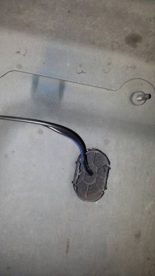

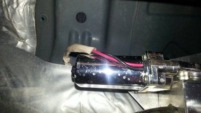

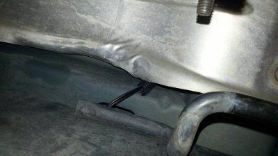

Ok here's what I ended up doing. With my longtubes and y-pipe and cutout after the 'y' the cutout ended up really close to where the jack is under my passenger seat. Didn't have to run much wire outside at all. Most of it I ran inside the cab. Here's a few pics I snapped of the wires coming out of the cutout then over the heat shield then through the plug under the jack.

good spot there
