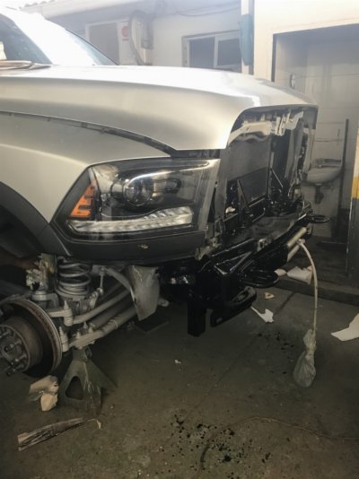

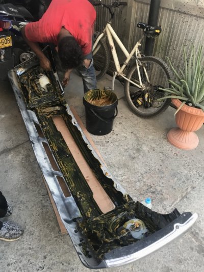

This is gonna sound like a lot of work but my truck is in constant contact with salt water... I just paint it like a boat or ship. All epoxy and grease behind the plastic panels.

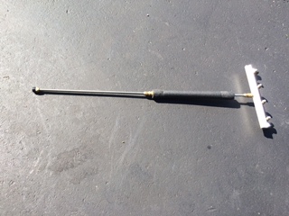

IMG_0758.JPG IMG_0760.JPG Krown works well and just as important in the spring make sure you thoroughly remove the salt & grime off the truck after the roads are clear of winter's residue. Not much actual corrosion occurs in the winter but once warm and humid conditions exist it is a breeding ground. See pics for my homemade undercarriage washer. The washer attaches to your pressure washer and rolls on castors. I added pipe insulation to the handle in case I hit the rockers on lower vehicles.

I have seen the home made sprayer on You Tube w/ pve pipe, BUT yours look like the best made ! Thanks for posting
