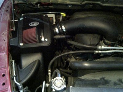

Finally got it installed after waiting out our cold weather...
FWIW the "scoop" isn't a "scoop" so much as a dropped second intake port. It grabs air from directly underneath the engine bay using a flat opening. It is not a "ram-air" setup. I'm sure you could fabricate something but it would lower your ground clearance and get torn off the first time you park close to a parking barricade.
It's quieter than I expected, but that helps keep the wife acceptance factor high. Sounds GREAT and throaty when you put your foot into it.

The scoop looks like a wonderful way to pull up a lot of water mist on a rainy day.
I do like the S&B intake though!
That won't hurt anything. My intake on the G8 literally sits right behind the grill and gets all the water into it. As long as it's running you're good. If it's not running and water gets in and somehow gets into the engine, you're TOAST!

^ I agree. My CAI's filter on my car was 7" off the ground, fully exposed, and never showed signs of a problem. I drive all year around and we get some pretty wicked standing water.
I understand water ingestion and hydrolock, but think people worry too much. Companies like S&B have to acknowledge it to cover their butts legally, but unless you're fording a stream I wouldn't worry. Even then, the original quarter panel intake port is fully available, then there is the 2' of vertical scoop ingestion the engine would have to provide enough suction to overcome, and the oiled filter, filter housing/box and tubing to the TB.
Furthermore, there is a cutout in the scoop a couple inches below where it inserts in to the base of the CAI housing where it fits over a "support tab" on the truck. More opportunity for it to pull air from another source if the scoop was submersed.

That's the best picture of the scoop I've seen. It's hard to tell what it actually does from the S&B pictures of it. I might get one anyway.
I thought we were a bit scoop info/pic lacking as well.
No, it's not great value at $99 but if you're spending $300+ for a CAI it's not going to kill you either, and why not maximize the benefits?
It would be nearly impossible to get pics at any other angle unless the truck was on a lift- sorry.
