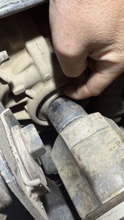

I just recently bought a 2012 1500 Laramie, and I am enjoying the truck. That said, this is my first RAM/Dodge/Chrysler product, so still getting to know it.
After buying the truck, I started noticing a rattling noise from under the driver’s side front. Especially noticeable on gravel washboard roads (which I live on…)
With some poking around, I found the noise to be this little loose ring where the axle meets the front diff/transaxle (shown in attached pic)
Looking for some knowledge about this part, shouldn’t be loose and rattling? Shoot I don’t even know what to call it.

That looks like a seal shield. Funny, I never really noticed that on mine.
If it's not leaking, I'd probably clean the surfaces, center the shield and put a daub of RTV in 3 places in the corner in the evening, and let it set-up overnight. That ought to keep it from rattling. But that's just my thinking.

Thanks for the idea. I have a sound that almost sounds like dragging chains, but the only thing loose that I can find is the dust shield. Will have to try something to keep it from rattling.

If its a axle seal, I would be checking the oil in the case, you may be low
But does not look like any oil leaking.
Another thing to check when a rattle starts is the heat shields on the exhaust manifolds,
bolts have been know to break and then the shields rattle, usally heat exhaust leak as well.

BTW I forgot ,Welcome from Canada There are a few of up here as well.
The transfer case should be checked for oil, that could be where the noise is coming from.
If you had it on a lift and run it in gear , then you may have a better idea about the rattle.
