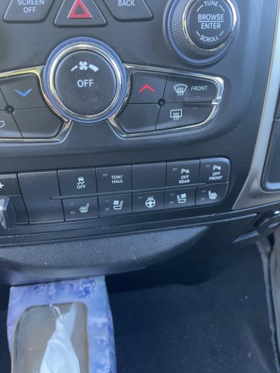

Sking80
Aug 18, 2021
131
54
Atlanta Ga
Yes basically you have the wiring already for the power heated seats so the swap should be seamless you have to get the panel buttons for it D82349AB-E1BD-4815-A544-7AD15BD8C9A7.jpegand in alphaodb you just have to enable the cooled seat features. What radio do you have
