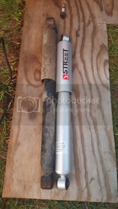

Rear stockers vs. 2212FF's for length comparison:

those shocks are amazing
